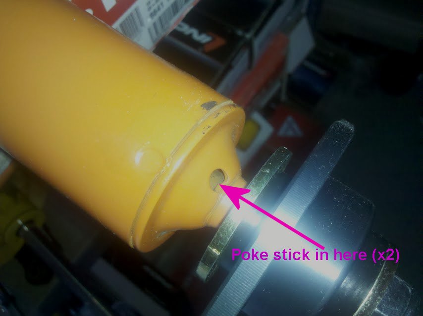

                    It is NOT possible to adjust a regular Koni while it is still on the car. Actually, you may be able to make some complicated special tools to do it, but it is faster to just remove the rear shock.
                    The trick that everybody forgets, is that the Koni bumpstop needs to be removed before the adjuster can be engaged.
                    Note: there are many many people who don't get this step, and THINK they are adjusting the shock, but they are not. This is why some people don't notice the damping changes, because there weren't any.
                    Here is how you do it:
                    You need: wrenches, and a long piece of wire to poke the bumpstop out. A bicycle spoke, coat hanger, really fat welding rod, or similar.
                    You can see the holes in this picture. There is a small black rubber bumpstop hidden in there, that must be removed before you can actually adjust the shock. The small black bumpstop has a slit in it, which allows it to be removed, then adjusted, and then replaced.
                    It is pretty much a pita, and that's why many people choose the specially valved e30 shocks that have the external adjustment in the trunk.
                      But of a thread resurrection but thank for the pictures I'd never have figured out removing the bump stop with out your info👍
