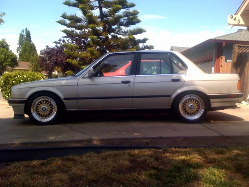

    Here are pictures of some setups people have (take note of whether the car is an early or late model because of the differing rear arches. Late models have arches that are about an inch lower so they have less rear wheel gap but more of a perceived reverse rake than early models)
    Eibach Pro-kit
    Eibach Pro-kit
    Eibach Race
    IE3 (no pads in the front)
    H&R Sport
    H&R Sport
    Vogtland springs with lower rear spring pads removed
    M3 springs
    Stage 1 Dinan
    KW 60/60
