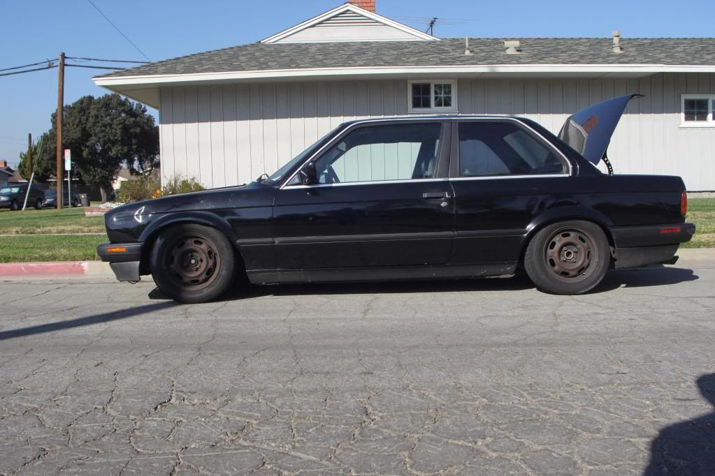

                ******WARNING******
                For those of you just now reading, this is not the standard setup.
                Cut perches
                Modified sleeves (still have 3/4" left)
                Cut 2/3 off the billie sport bump stops
                No rear adjuster or bottom spring pad
                Tucking front and rear tire on 195/60/14
                www.gecoils.com

                    I did not shorten the housing, i just modified the sleeves. The JOMs won't allow you to shorten the housings either. I bought them with the original group buy when they were $380 and i sold the shocks for $150 so i really only ended up paying $230 for them. Thats about half the price of ground controls. But i have since moved on to my own line of coilovers.
