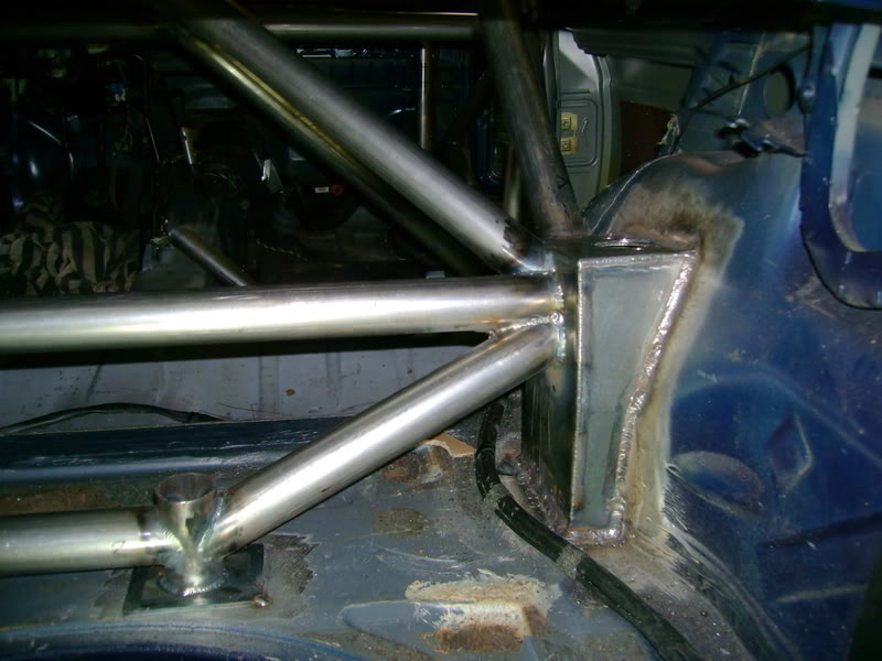

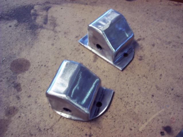

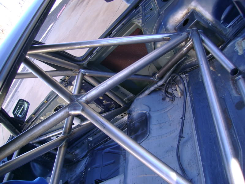

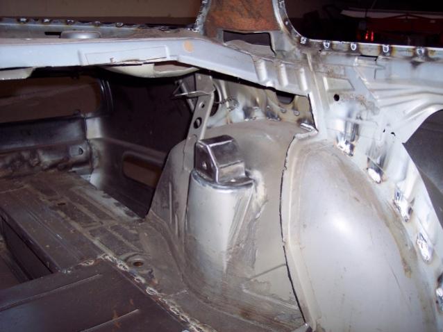

    ahhh ill direct you in the right direction... view photos below
    the first two are from gary's m3 v8 build, i forget what page they are from.
    the other two are just a really well done road course cage with boxed shock towers as seen below.
    honestly, unless your going to do a full cage and need the advantages of going to a true coil set up, dont do it. the stock set up is fine for DD and track use. it's not just a simple modification of the tower, you also have to reinforce the subframe and especially the trailing arms to take the added stress.
