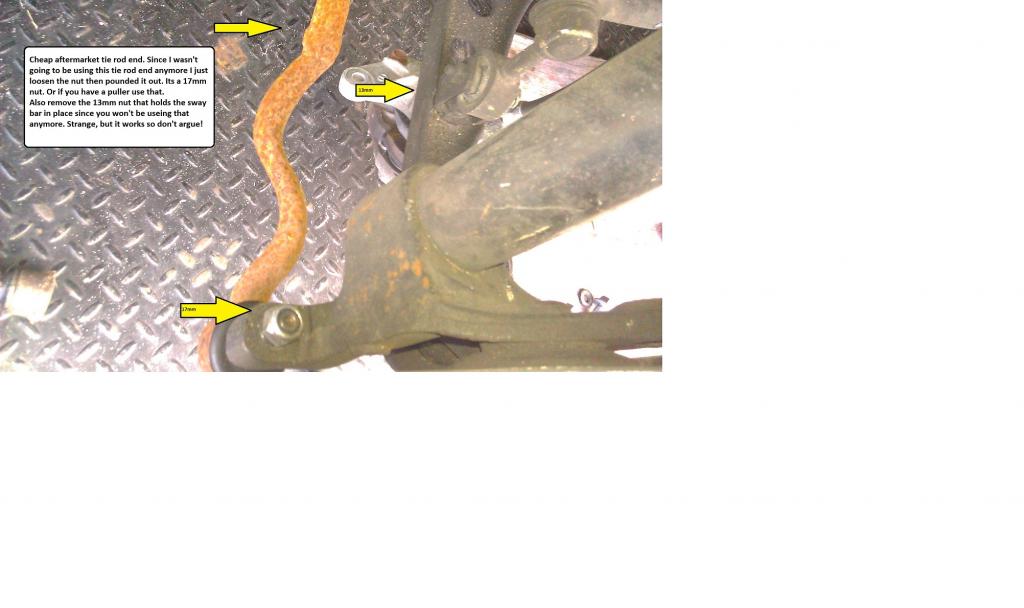

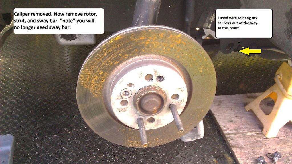

    Well I'm not to sure if anyone needs this but I got my Wisefab kit in 2 weeks ago. Just haven't had time to do the write up. I finally was able to do it last night. Hope it helps and if you guys have any suggestions let me know.
    I haven't been able to slide it yet but will post results soon. Be sure to recheck the bolts after the first couple events to make sure they haven't loosened.

                  I tried to make it as simple as possible. It was a well designed kit. Not much guess work. But the directions they gave me were very basic. Ardo at Wisefab was very helpful and I got the kit fast. As well Est Performance made sure I had everything I needed. Big thanks to them both.
