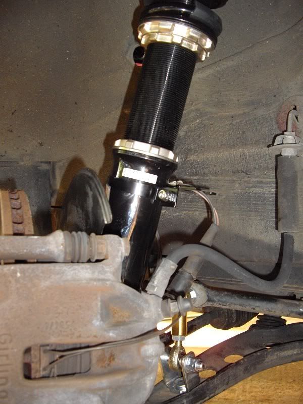

    Cool video.....I kinda learned something. But now its the welding to the knuckle is where i really worried. and what shocks does BC come with? Obviously not Koni's...
    nothing to worry about, unless you weld crappy or your welder welds like crap... get someone that is confident, heat the cast, and make sure its clean.... let air cool after welding...
    If you're really tripping, you can put in extra stiffening/brackets to strengthen... I didn't, I trust my welds.

      why worry about weld?? when the factory did the same thing.

          out of interest, would anyone have the instructions to determine how much of the strut to remove before welding?

            You're supposed to leave 50mm of the original strut housing on there.

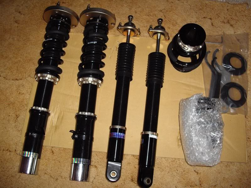

                        I have one question. How low do you want to go? Bcs will lay frame. Gcs will not and will ride like dick/blow konis once super low.

                          that depends on so many factors!
                          the length of your strut inserts
                          how long the remaining housings are after you modify them
                          the length of the springs you choose
                          where you weld the perches
                          stack height of your strut mounts
                          bump stop length
                          saying you can't go low with GC is idiotic. it will go as low as you want to build it for. blowing konis? what random chinese shit is inside the BC kit? who makes the inserts? how many people have 100,000 miles on a BC strut insert? Bueller?
                          besides, if all you want is a dumped ride that "lays the frame" - it's going to handle like shit anyway (yay roll centers and camber curves!). Just take out the springs and put some 2x4s in there, it will handle about as well.

                                Originally posted by nando
                                please, tell me how you can use a shorter strut insert without loosing droop. you can't have it both ways - if you lower the car 3", to get bump travel back, it has to come from *somewhere*.
                                Stop looking like an arse just because you dont understand how the product works.
                                Spring height adjustments result in preload only as you are adjusting the bottom spring hat upwards towards the top hat, it doesnt change ride height at all. Inside the strut the threaded section is basically just a tube around the outside of the shock, so when you wind the WHOLE strut into the bottom section that is welded to the stub axle, you dont actually move or reposition where the piston is sitting inside the shock. You could wind it all the way to the bottom of its travel and its still sitting in the same place as you arent actually compressing the shock OR the spring. You are essentially winding the stub axle up into the strut body, so shortening the distance of the tube between the shock and the bottom of the stub axle.
