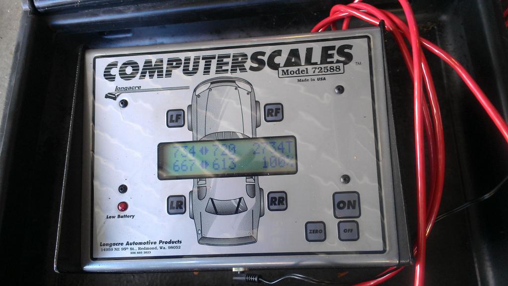

    My SE30 was oversteering quite a bit at the last track day we went to. It would push if you went in way hot, but in steady state cornering and coming out of the corner it wanted to swing its tail. I thought the solution to this was to soften up the rear sway, but when I got home I found the rear sway to be on full soft. I don't think it's rollover-oversteer because I just wasn't getting that much body roll. I stiffened the rear bar about an inch to see though.
    I'm running about -3* camber in the front. Standard SE30 suspension setup. Car corner balanced slightly front heavy (~720 on front wheels, 620 on rears).
    Ideas?

            Doesn't lower = lighter? The corner weights were "about" that, I didn't remember the exact numbers. But here they are. I think I'm going to try to eliminate a little weight in the front, but I don't think that's the root of the problem.
            Tire pressures were 35 all around. Running Star Specs, not the spec tires.
            It wasn't terrible, just...pretty loose. I will have to check toe and camber tonight, but I thought it was at zero. Rear camber isn't adjustable, is it? And I thought toe was only adjustable via ride height?

                  Your cross weights are way off...your rf/lr should be the same weight as the lf/rr. The way you have it the car would push in one direction and be loose in the other. Get them equal and then worry about push or loose. First things first. Chuck

                      When corner balancing one adds weight to the light wheels. In this case (as is usual) the light corners are from the left front to right rear. Adding spring pads at either or both of those and/or taking spring pads out of the other diagonal will make the corner weights better. As will adding weight to the light corners.
                      The car as it sits now is nose heavy, so if you add weight you want it on the right rear corner. I don't know if the car is carrying ballast, but if it is moving the ballast to the right rear corner is something to consider.

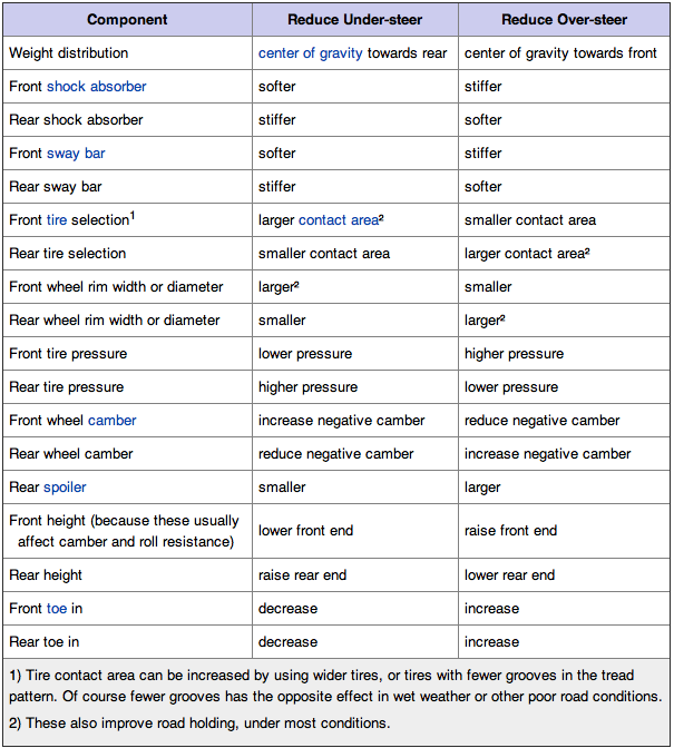

                        from wiki:
                        In steady-state cornering, front-heavy cars tend to understeer and rear-heavy cars to oversteer, all other things being equal. The mid-engine design seeks to achieve the ideal center of mass, though front-engine design has the advantage of permitting a more practical engine-passenger-baggage layout. All other parameters being equal, at the hands of an expert driver a neutrally balanced mid-engine car can corner faster, but a FR layout car is easier to drive at the limit.

                              Originally posted by VinniE30
                              Correct.
                              I don't agree that moving weight to the rear will reduce oversteer.
                              More weight in the rear will increase oversteer / reduce understeer.
                              More weight in rear is more mass that has to change direction in rear and hence less grip on rear tires and hence oversteer.
                              You're probably thinking of a scenario in a straight line drag race where weight in the rear would increase grip since the car is only going in a straight line.
                              Do some reading if you don't believe me.
                              from wiki:
                              Link to said article?
                              In an ideal situation, you want equal weights on all corners, hence the MR layout. That description seems very simplified.
