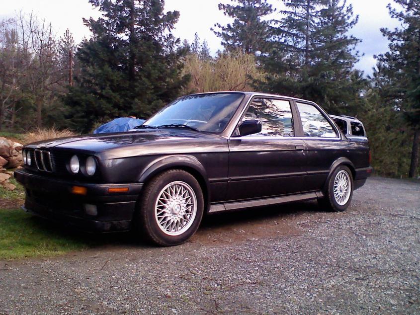

        Here's a pic of one I did recently on Konis...
        You can go lower, but I wouldn't recommend it unless you have a collection of front halfshafts.
