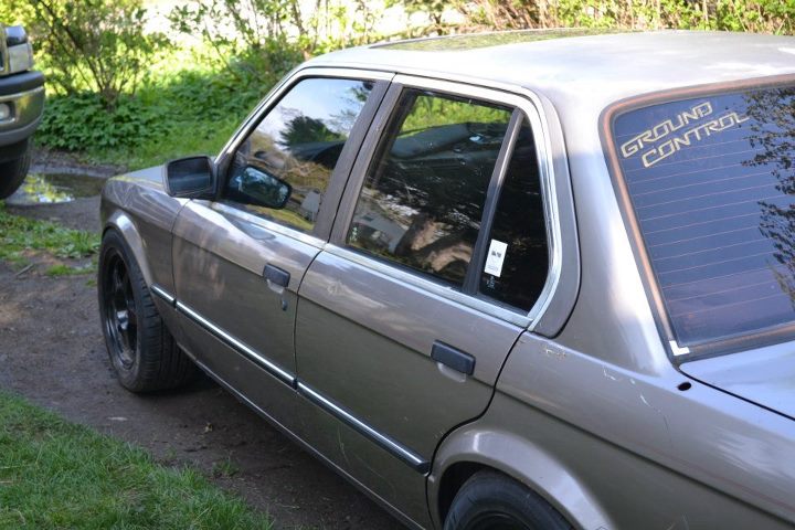

                        Tires and wheels(even for fakes) look great on your car, only thing is you have too much rake in the front.
                        Here is my setup OP:
                        GC coilovers, GC e28 race camber plates(12mm gained drop over stock hats), Shortened housings by 1" and made custom perches to allow the adjuster nut to spin beyond for more drop. Koni valved inserts. On Rota Slips 16x8 et20, Nexxen CP641 225/50/16.
                        There is nothing wrong with 225/50 I think if you're not able to close up the wheel gap, you should not run shorter tires. Post up some pics of you car with the current setup. I am able to close up any amount of gap I wish with my suspension, but it all depends on what your running.
                        I personally think your car will look amazing with 225/50/16 all around. I highly recommend these tires I have on. Only 106-115 per tire =)
