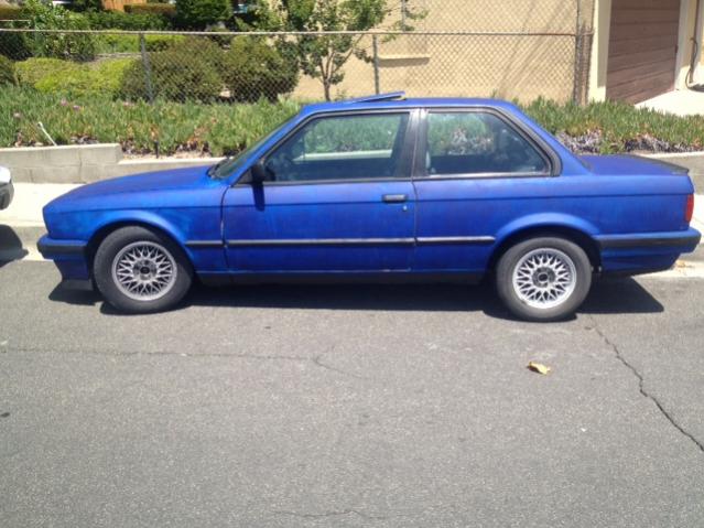

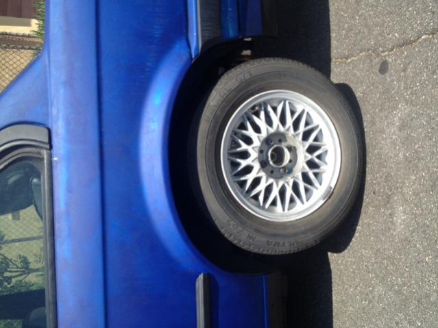

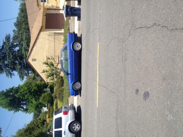

                        pics, looks worst in person

                            It takes me a little over an hour to change all 4 springs, there is NO OTHER WAY to make the rear of your car lower. You need different springs.
