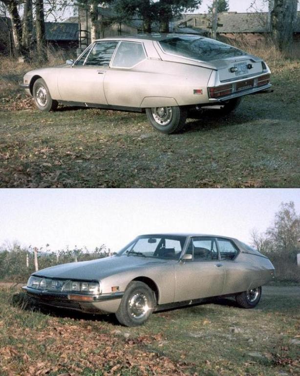

                              ...and I think you will really like the 3.2 rack relative to the 4.0 you have now. This from someone who has had a DD with a 2.0 rack (see pic).
