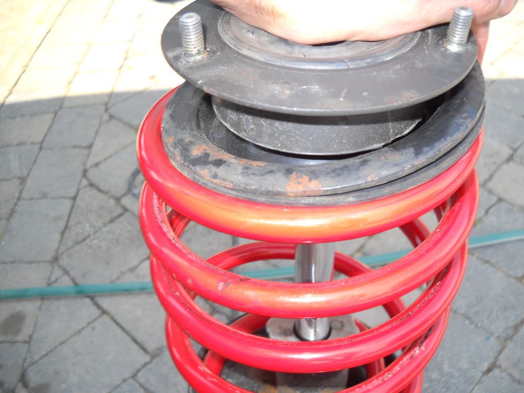

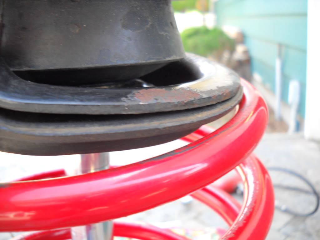

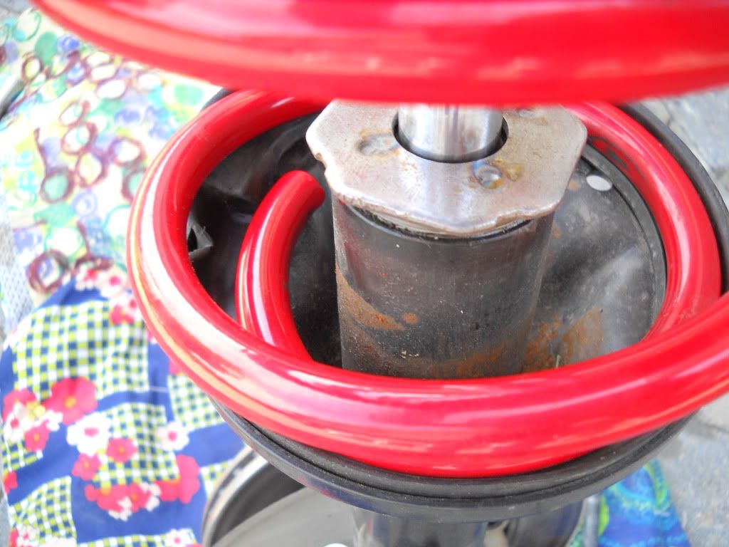

        Just bought the e46 springs because they were dirt cheap. It looks like the back springs will fit but the fronts are a little different diameter at the top and bottom.

            Looks like the front springs will not work. The coil windings at the top are too big and at the bottom their too small.

                        will not work either :(
