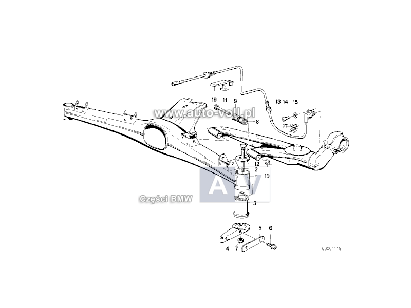

                  Unfortunately it was wishful thinking that the creak went away after disconnecting the rear sway bar link brackets from the rear trailing arms. It actually had no effect. the sound seemed to be coming from the outside aspect of each side of the rear seat. I went and pushed on the rear subframe bushing cover plates, and the sound was reproduced. Then I sprayed some silicon lubricant on the joint between the bushing and the cover plate (parts 3 and 4 on the rear axle OEM diagram). The noise was significantly reduced, although not eliminated. I am going to let it soak over night and then try an extended drive tomorrow. If this turns out to of only temporary benefit, I guess I could remove the large furled bolt (#2) and try to cover what I can with grease and re-install the bushing bolt, cover and nut.Click image for larger version  Name:	33311135122-oryginal-bmw-ac37.800x600-s.png Views:	0 Size:	43.4 KB ID:	9887891
