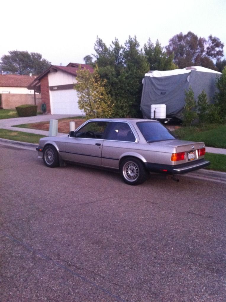

                here my e with 1.5 drop anyone know how to fix the rake.
                      Looks great! remove the rear spring pads and it should level it out

                          #177
                          Part of your problem may be that since the springs are designed for a 318is and you have a 325 the extra weight of the i6 is making it rake forward more than usual
                          • mr ilia
                            • May 2011
                            • 582
                            #178
                            In all cases, rear springs take longer to settle, the drop in the back will be more apparent after a week.
                            Also, the car seems to be on uneven ground, making false impression on the drop.
                            • glnr13
                              • Oct 2011
                              • 1334
                              #179
                              also, is your ebrake up in that photo?
                              • clintbmw07
                                • Jul 2012
                                • 23
                                #180
                                Well I took that picture on the first day. They have settled a little more but do you think removing the spring pads would help even it out?
