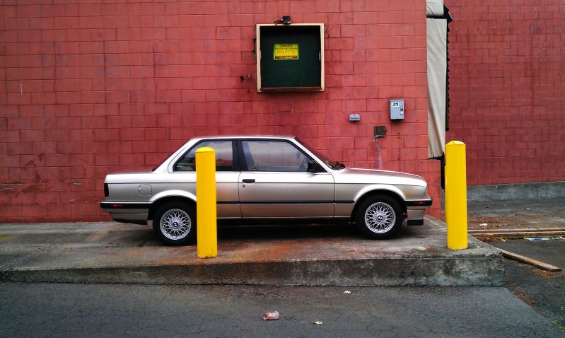

      Installed!
      Sorry for the iphone picture but its been pouring rain this weekend.
      Previously I had 7" clearance with the IS lip and now its 6" with the ST Springs.

          It is hard to judge, from that angle. Just post better pictures after getting your sedan fixed.

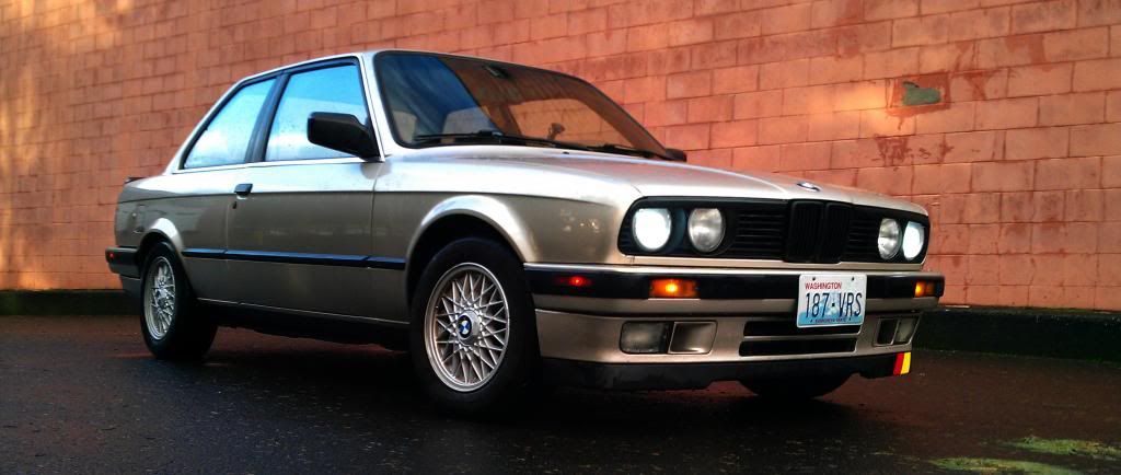

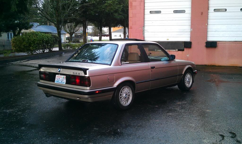

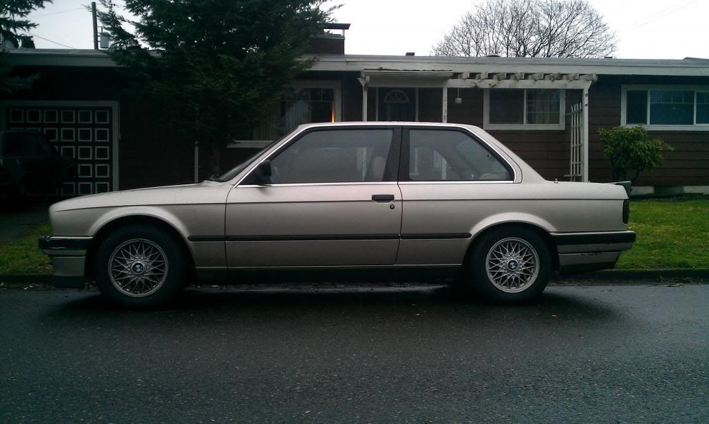

                          Finally got these installed.
                          I ordered the E30 M3 lowering springs which are a 1" drop, however, the stock ride height of the M3 is .5" lower than a standard 325i. I figured since there were no information of the spring rates, I might as well do M3 springs rather than 318i springs. I'm using brand new Bilstein sports with new Boge strut bearings in the front and the spring pads are still in the car. The ride feels a lot better than stock. The springs are soft enough to where it doesn't suck to drive on bumpy roads but stiffer than bav auto springs.
                          Overall I'm happy with the springs especially for $70 shipped! I was too damn excited to put them in so I forgot to measure the stock springs but here's some pictures for reference.
                          Before
                          After
