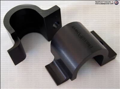

    Common problem with larger bars. Need to buy some reinforcement plates.

          looks like ireland only makes those for 19,22 and 25mm sways,correct me if im wrong but verts have 21mm

            I am contemplating how to fix it. Ireland engineering has this:

              the plates ireland makes are fine just dont fit verts

                Why would they not fit verts? There's a big "other size" blank box.

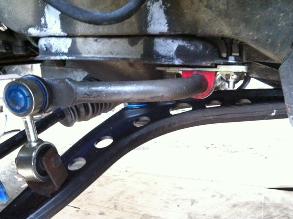

                    Its a choice of 19 mm or 22 mm with itelands kit. The vert is 21 mm. Buy the 19 and ream out the bushings. Real easy to do! Such a better design! DOOOOO IT Click image for larger version

                      So if you guys look at the second pic I posted I looks like I snapped off a tab. I think I'm screwed...

                        Well time for a new subframe! Good thing its already out!

                          I thought the point of that Ireland engineering mount was that you could eliminate the need for the tab because the plate is secured to the subframe.

                            It eliminates the tab from the mount not the subframe. My picture above shows the original mount being used as well as the subframe bolt.
                            The tab thats removed is similar to these e39 brackets. those can bend and pop out since theyre secured from only one side (the part thats missing from your subframe
