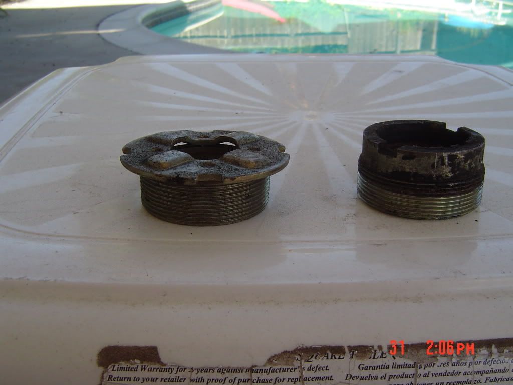

        The gland nuts come with the bilstein cartridges (inserts).
        Stock BOGE gland nuts do not work.
        stock vs billy pic..
