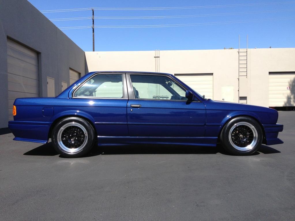

I am running 87 body with aftermarket bumpers. BC Type BR Coilovers 10k front and 12k rear with 16x8 +20 on 225/50/16 and 5mm spacer in the rear. I was on 'zero' pre-load and it was sitting a bit high. then i gave it about 8 turns on the rear struts to lower it a bit and it's looking pretty good. If i remember correctly, my spring length is 140 or something...
LeoComment
Great color! Car looks great, but isn't it bone jarring with those rates? I've got 440/650 and it's a little rough for me sometimes.I am running 87 body with aftermarket bumpers. BC Type BR Coilovers 10k front and 12k rear with 16x8 +20 on 225/50/16 and 5mm spacer in the rear. I was on 'zero' pre-load and it was sitting a bit high. then i gave it about 8 turns on the rear struts to lower it a bit and it's looking pretty good. If i remember correctly, my spring length is 140 or something...
