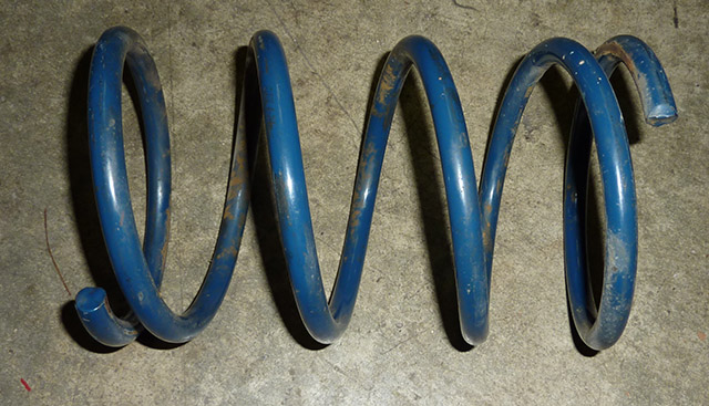

                              I'm half way there. I found 2 front springs in Pick n Pull today. I have no idea who makes them.
                              They are deep blue in color, no markings. Anyone have any idea who makes them?
