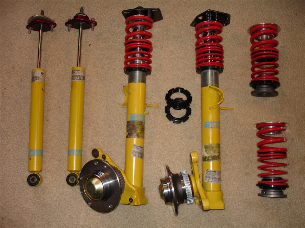

            They are progressive springs, which takes a little bit of the edge off and gives the spring essentially two built in rates. Similar to the idea of a helper spring on coil overs as seen below. Under load those smaller helper springs will collapse.

                They are made that way so that when your shock is at full extension, the spring doesnt fall out. The compression on the spring to that of the shock on an impact is fractional. With the shock fully unloaded, the spring would be loose.

                    The front H&R race springs have the top 2 or 3 coils bind and the rear have the 3 in the middle bind by design. This means, the 2 remaining coils in the rear are doing the work. Really it's the only way they could have done it to achieve the desired drop given the honeycomb shape of the springs.

                        Nothing to do with being progressive. As you noted, those coils bind right away under the weight of the car which makes them inactive and out of the equation. Many springs like HR sport and Eibach's are also progressive but don't bind like the race springs. They aren't as low and aren't as stiff.

                          It does have to do with them being progressive (not the noise, but the springs looking as they do) as there are two rates in one spring. Its not for when your car is jacked up persay, moreso just for when the shock is extended in an on road situation to provide some tension still to the perches and to keep the spring in place.
