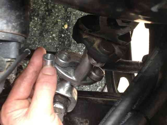

                            • mccor023
                              • Jul 2011
                              • 683
                              Originally posted by Wh33lhop
                              Actually the Z3 rack may NOT require knuckle modification. E36 racks do, but the splines on the Z3 rack go deeper (oh baby) and may not require knuckle shortening.
                              The funny thing is, the Z3 rack is such a huge improvement over the stock rack but it's still not THAT fast. For instance, try driving a car with a z3 rack and then driving an Evo or a Mazda3.
                              I'm starting to think that is the case! I started this solo and after giving up attaching the knuckle to column and then knuckle to rack (w/ spacers installed). I separated the knuckle, inserted the top and installed rack to subframe w bottom half of knuckle. Now im looking and there is no way the spacers will fit, and Im doubting everything. Click image for larger version
