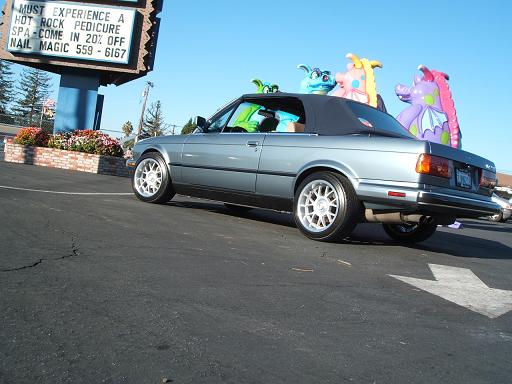

          I went with Bilstein Sports and H & R Sports (vert specific spring rate)
          I like the drop in the front , but the rear is just a bit too high for me and gives it a bit too much rake. I dont run a spare tire so that may account for a bit of it.
          The ride quality is quite a bit stiffer then stock (of course) and definately streetable. Its a great combo as many have already attested to.
          I am considering going with the adjustablity of the Ground Control and Koni's . It would be nice to dial in the ride height and not be limited to a static height and dampning rate.
          Good choice if you go that route.
          My current stance

              Hey what size are them Cr7's?? I always loved them wheels but they look kinda huge on your vert.

                16 's . Thats just the angle of the picture that accentuates the rim size.
                The picture is being taken at an up angle and thats what optically enlarges the look. : )

                  Well I have seen other angled shot of your car before and they still look big, But I'm thinking it may be due to the metal bumpers,short valance, etc. Dont get me wrong I still love your car ;) What color isd that Cirrus?

                    Cirrus Blau! Correct
                    If you want to see large CR7's then look at them in 17's here - They are large! Mine are small by comparison : )

                      my eyes suck then cuse I cant tell the difference.. But you got 16" (how wide?) and are running what? Bilstiens & M3 springs??

                        I can totally notice a difference in size from the 16's to the 17's.
                        Mine are the 16 x 7.5 , but may be the 16 x 9's- Cant recall.
