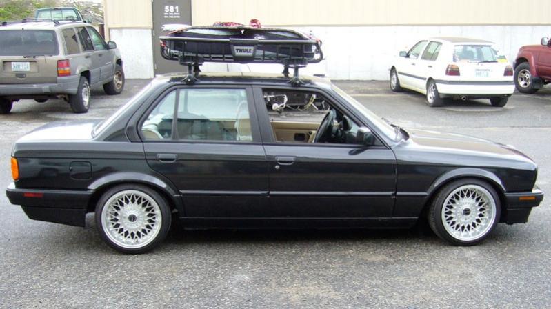

              Ok great. So as long as i replace the usual suspension parts that are worn and put the KWs on and some GC camber plates i really should have a sweet setup then. Heres a pic of what the KWs look like on POs E30:
