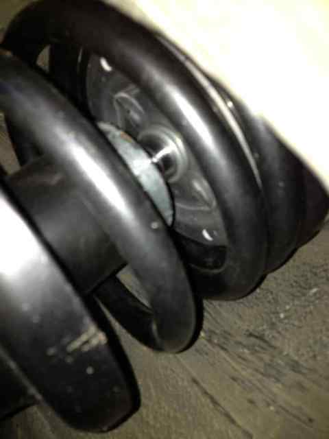

                On second thought, I was probably simply riding around on the Bilsteins bump stops before.
                Current picture of shock travel with car on the ground and Koni w/ out bump stops.

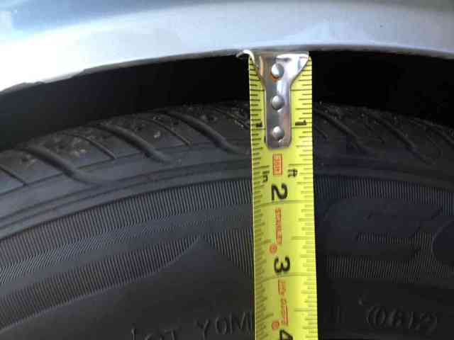

                Tire to fender gap.

                • butters
                  • 1206
                  holy lack of travel. and with no bump stop? how's this working out for you
                  • mccor023
                    • Jul 2011
                    • 683
                    I was feeling ok about it until this picture and I realized what was happening. It seems my trial and error continues as Im adding the spring pads and stock hats back in until I can order GC with shorter housings or AST from Vorshlag.
