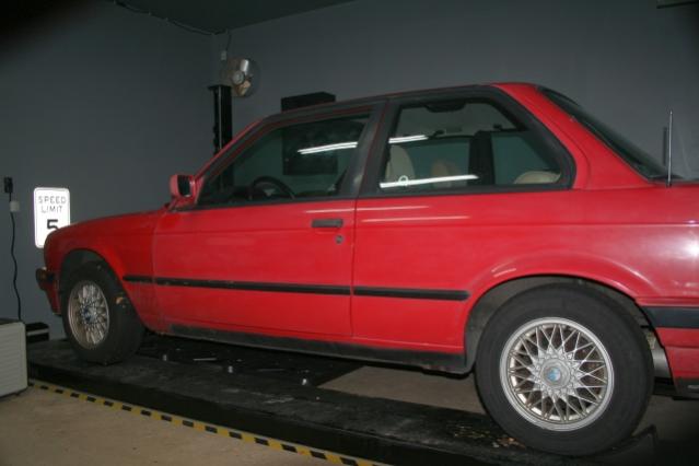

    Pic at bottom just because a pic-free thread is boring:
    Car has 200k on it, and everything must be assumed bad I guess. I'm not looking to slam the car, and want it to remain fairly comfortable - but I'm willing to come close to slammed/uncomfortable because I hate wheel gap and appreciate handling. I'd considered a 5 lug swap, but with so much else to buy either way, can't absorb the added cost, plus by staying with 4x100mm I can interchange wheels with my '91 mazda mx5 easily.
    Parts I plan to buy:
    * Bilstein sport shocks - Turner motorsports $468
    * H&R super sport springs - (part 50404-77) $230 @ Turner (supposed to lower a bit more than sports, bit less than race, spring rates similarly in middle)
    * E9x Front Drop hats - Ireland $26 - should front shock mount/bearing be replaced? Oem for that?
    * Lemforder LCA's $120 Bavauto
    * E30 M3 offset CAB's $45 Bavauto
    * E30 M3 front sway endlinks+garagistic weld on strut tube mount tabs $?+$18
    * Rear shock mounts - Haven't decided on brand/type, suggestions?
    * Weld in rear shock mount reenforcement plates (garagistic) $20
    * Spring seats. Notsosure what to do here because I don't want to introduce more fender gap. But at what cost for comfort...
    * Sway bushings front/rear
    Bit over $1k total or so, I reckon.
    Parts I have:
    * Powerflex rear diff bushing
    * e30 325ix vLSD
    * Poly subframe bushings (AKG)
    * Poly rear trailing arm bushings (BMP)
    * e21 tranny mounts and UUC enforcers (installed)
    * e36 M3 oem hydro engine mounts (installed)
    * Brake stuff - big bore OEM master cylinder, Axis Ult Pads, rotors, caliper rebuild stuff, stainless brake/clutch lines. Need to replace corroded hard lines as well.
    Any suggestions? Considering doing the front/rear hubs/bearings as well, particularly if I'd have to remove most of the suspension stuff to do them later on. Better swaybars/shock tower braces I'll do later on.
