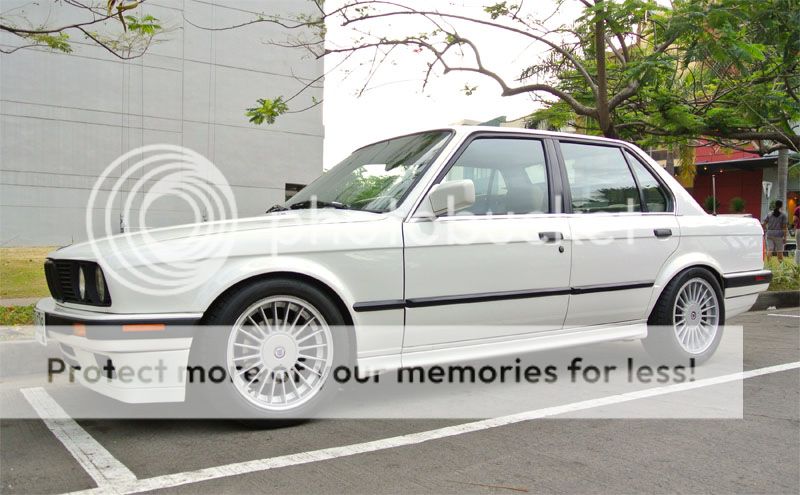

    Hi Guys,
    I been doing a lot of searching on what shocks to match my eibach pro kit springs. I know lot of people find it too soft for them and went h&r race/sports. Since pro kit is what I already have, I'm gonna stick with it and spend my money on shocks. I'm thinking of Koni SA or Bilstein Sports but haven't decided yet.
    It's for daily and spirited driving. My current shocks are bilstein touring and they giving up on me so they need replacement. I'm looking for more handling on corners so the fender won't rub the tire and will last long.
    My wheels/tires are: Alpina 16x7 with 205/50 (20mm spacer installed on the rear wheels)
    What can you suggest?
    Thanks in advance.
    Here's a pic of my car:

      ^ car looks awesome
