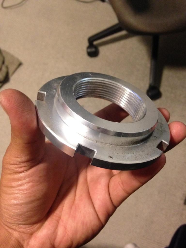

              heres a pic i took earlier today. not the greatest, but you get the idea. i can only fit about 3 fingers under the lip. my low profile jack doesn't even fit under the car. I had to put wood under just to get the jack underneath.

                Originally posted by mr.vang
                Look like there is suppose to be a second collar. I guess the PO want it as low as possible and took the other collar out. If that is the case, once that collar moved up, that collar won't stay in the position you adjusted to. The missing collar is suppose to lock the two collars in place.
                There's a pair of these in the trunk
                Build Thread
                • mr.vang
                  • 4371
                  ^ look like you found them. Those goes on top of the other one.

                        just make sure you place the ones you found in the trunk under the spring. They are actually the spring perch, hence the step in the ring. The spring slides over the step to help locate it, then the other ring sits below this one to lock it in place (you tighten it up against the perch).
