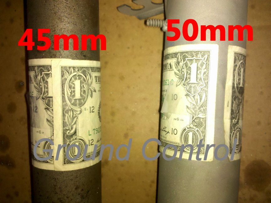

    hey guys, im not very confident when it comes to coilovers, i dont really know what all the specs mean and etc but i do need them on my car. So anyways, i have 1984 325e (2.7e) so if i understand correctly i need coils that fit models with 51mm strut tower, technically those should work then, but when i do put in my car to see if its compatible it says its not. im just confused here, and i know that the question is stupid but just dont want to order the wrong ones. Thanks a lot

    The one you had linked will need the stock housing cut at the very bottom and weld in the coilovers. The rear just mount right in without modification.

        I would double check your strut housing as some early eta have the smaller size housing. If you are 100% sure your housing is 51mm, then these should work with your car.

          i believe only US 84-85 318i models came with shortened strut tubes, so guess im fine, thanks again!
