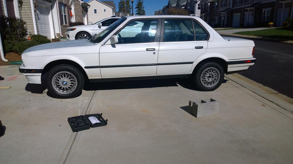

In search over taller springs
  • JNSmith1717
    • Oct 2014
    • 35
    Another pic , sorry my phone will only let me post one photo per reply
    • JNSmith1717
      • Oct 2014
      • 35
      Also in the process I noticed I had the 9mm upper spring seat on the RF and the thinner on the LF, going to fix that when I do the struts
      • JNSmith1717
        • Oct 2014
        • 35

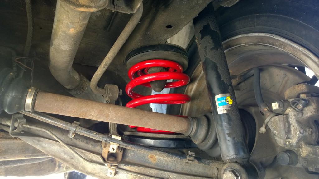

        Made some spacers for the springs in the rear
        • JNSmith1717
          • Oct 2014
          • 35

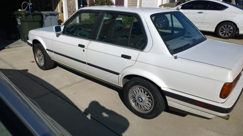

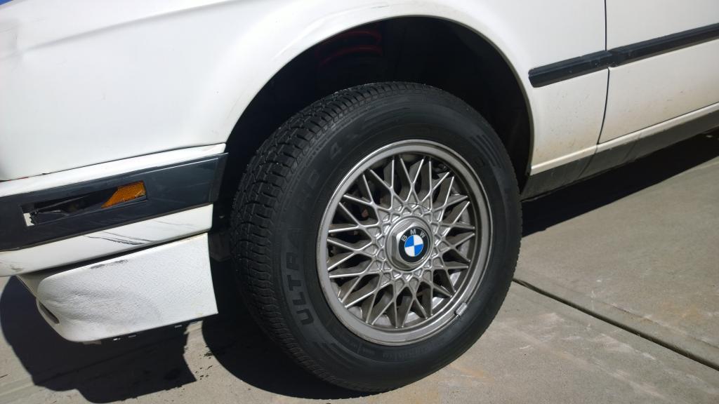

          Pic of the front
          • JNSmith1717
            • Oct 2014
            • 35

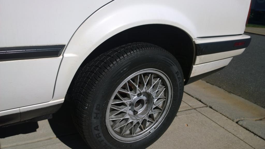

            The rear
            • JNSmith1717
              • Oct 2014
              • 35

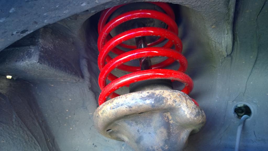

              Front convertible springs
              • JNSmith1717
                • Oct 2014
                • 35
                Rear convertible springs with .5" hdpe spacers above and below the springs

                              It looks like you have Bilstein touring shocks - what are your impressions?
                              • JNSmith1717
                                • Oct 2014
                                • 35
                                As far as those shocks, don't have impression, there were blown got some bilsteins from a Jetta in rear now longer and not blown
