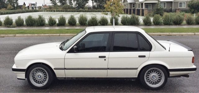

        Again, I suggest E30 M3 springs and Koni Sport Adjustable dampers/struts. Lowers the car a little but not enough to make me nervous, and the ride is stiff enough to be sporty but smooth enough that I get compliments almost every time I give someone a ride. Here's a shot of the car from the side:
        [IMG]http://i1256.photobucket.com/albums/ii482/ELVA164/Facebook/The%20325i/Washedrightside.jpeg[/IMG]

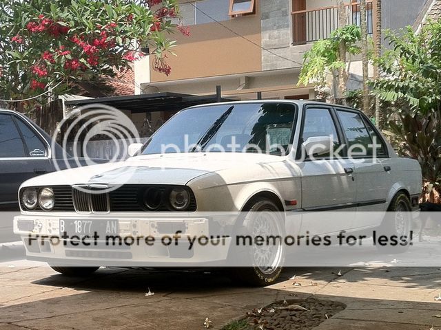

                      I'm using H&R race and billy sport... Use as daily, comfort and feels like a gokart.. Running with 205/55/r15 for winter and 195/50/r15 semi slick for summer...
