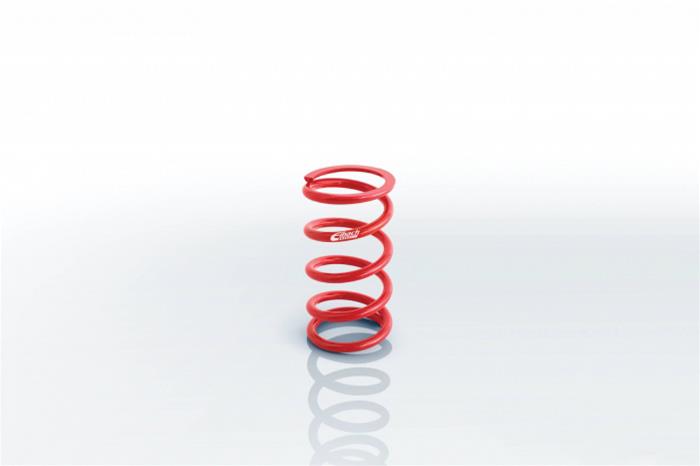

Found one thing
Free Shipping - Eibach Coilover Springs with qualifying orders of $109. Shop Coilover Springs at Summit Racing.
$65 dollars a spring is a lot though. I said 6" length because megan racing says the rear damper specs are; R: 150mm stroke; 250mm length; 44R01 valving code.
I would be looking to match the stroke with the length of the spring, right? 150mm comes out to ~5.9 inches.1991 325i Calypso Coupe

Found one thing
I would be looking to match the stroke with the length of the spring, right? 150mm comes out to ~5.9 inches.Comment
