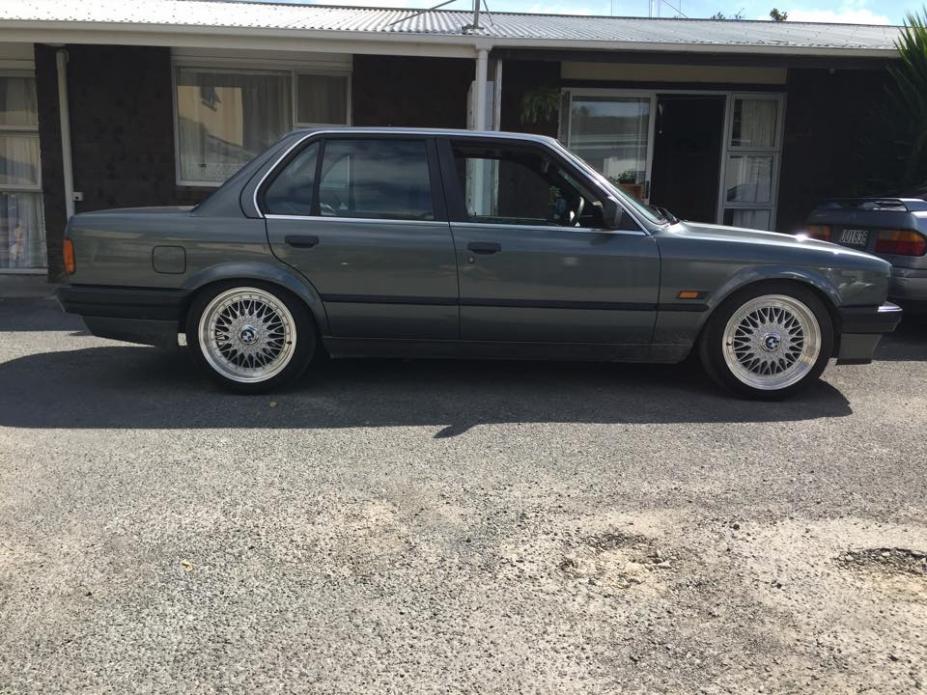

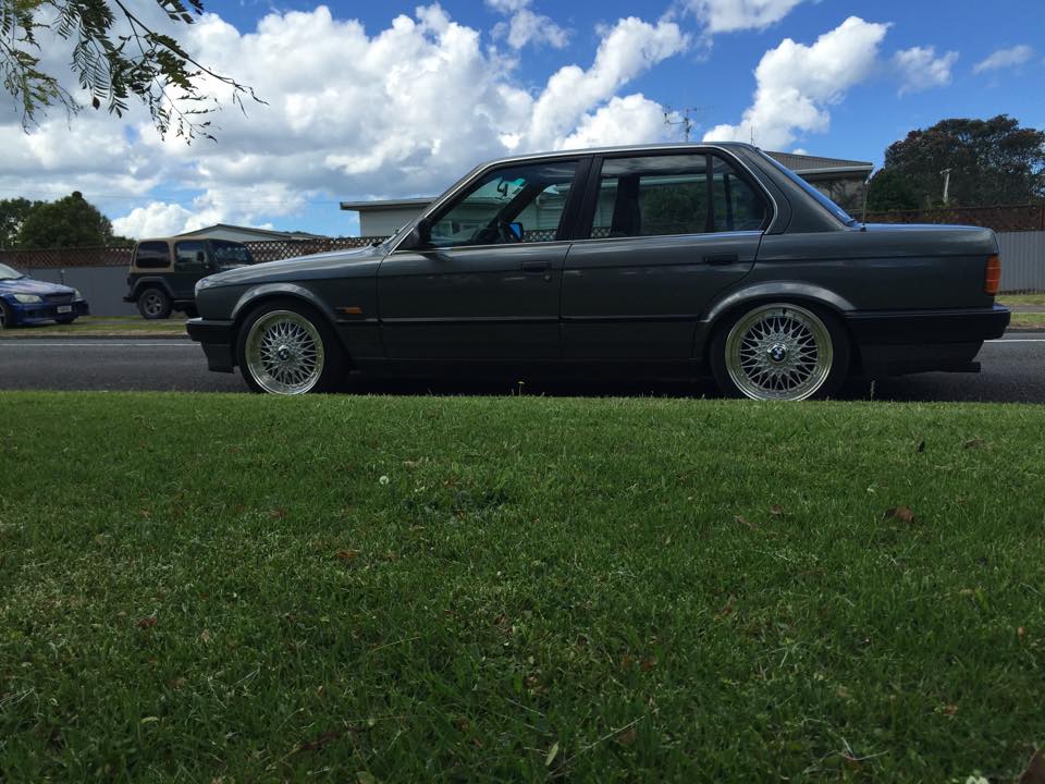

    Now that I have your attention, I hope somebody can help me out
    I'm hating on my "reverse rake" at the moment.
    I recently went and bought 4 more spring pads that I'm yet to stack in the rear to raise it a little, but maybe I should just go lower in the front as well?
    I'm just on lowering springs but is there anyway that I c an go lower?? I know coilovers are the best option but don't have thousands to spend atm.
    Any help is appreciated!

        What springs are they? The issue is the springs. If you want to go lower and correct the rake you're going to need new springs/coils/air. Or you can try e90 drop hats in the front. I would not just start stacking spring pads in the rear.
        • JordsProject
          • Dec 2014
          • 21
          They are Dobi Sports, the light green in colour.
          Here in New Zealand we don't have many options in lowering springs unfortunately.
          I've heard thicker spring pads do help a lot from a few people, may still try it.
          I really want coilovers but is it worth it for a standard 318i auto. I don't think so haha

                  • jalopi
                    • 2370
                    space the rear springs up some. best part about it is you can just make your own spacers out of most rubber materials - just cut in the general shape of the pad + a hole in the middle, put underneath the factory spacer, done
                    • IronFreak
                      • Dec 2012
                      • 3702
                      You don't have reverse rake.....you have a late model.

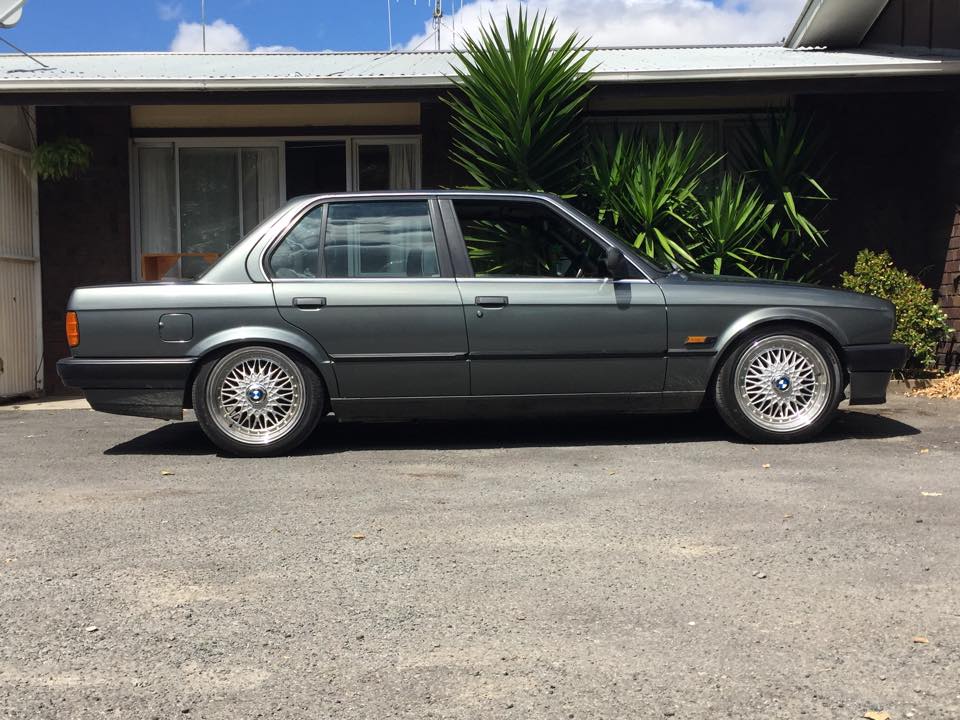

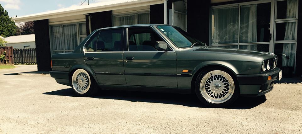

                          Just a quick update, went down to the local wreckers and found 4 spring pads that i cut the nipple off to fit under the original pads on top.
                          managed to fit them all on so around 15mm in total including original pad.
                          I think it looks alot nicer!
                          what do you think?
                          • jalopi
                            • 2370
                            +1 on Iron's comment, it's a late model, it's always gonna look like the rear is alot lower.
                            personally i thought it looked fine before, though maybe it's more pronounced in person
                            • stonea
                              • 2892
                              Looks much better IMO
