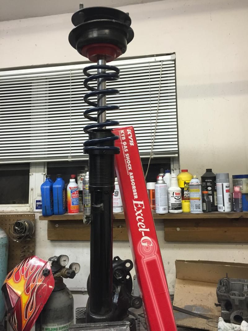

                      Some updates, removed the struts from the car today, one shock is toast. While I was in there control arms and tie rods are getting replaced, they are the original ones, with over 340k on them so deff time to replace.
                      John from WOT is helping me out with new shocks and set up (since I haven't a F-ing clue with coil overs), and Carlos from Condor with the springs.
                      Ordered a set of Koni threaded sleeves for the struts, lets see how this whole thing comes together.

                          No doubt, I'm lucky they are local. Bought new Lemforder control arms, tie rods, touring shocks and boots from John @ WOT he even threw in the centering tops to the coils.
                          Picked up the 150# coils from Carlos @ Condor.
                          Threaded strut collars are scheduled for delivery tomorrow. I'll have it all put together over the weekend and post up pics.

                              I'm noob myself when it comes to coil overs. But with the guidance from John at WOT I have learned quite a bit.
                              Threaded collars and nuts are from jegs. The ID was a touch small to fit over strut housing, used a cylinder honing stones on a drill to bore them out a touch. Put the strut housing in the freezer and heated up the threaded collars and pressed them together. Then welded a few beads under the collars.
                              Strut tubes are stock length. 175# hyper coil springs with kyb touring shocks.
