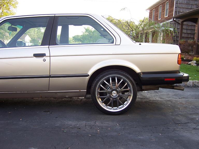

    Can anyone tell me why this car still stis high eventhough i installed the eibach pro kit? btw i have tokico shox.
    I nees a solution for this. any idea? hello need help

    Dont really know too many reasons why, my guess would be if the shocks were designedb for factoey springs rather than lowering springs. I have heard of the mix up before and the car rode high.

      i think springs that changes the height of the car not the shox. correct me if i'm wrong

        The shocks can have a slight effect, I hear depending on the valving. Not that much though.
        Are they brand new?

          If you JUST installed them, they need time to settle... or if you got some fat friends take them to get a burger ...or two and that should do the trick.

            Is your parking break on after jacking up and lowering the rear end? If you leave it on, it will not allow the suspension to rotate back down.
            Those tires look WAY undersized too. That could be part of it, playing a trick with your eyes.

              small tires, early fender arches = lots of gap

                ^^^ Bingo. Give it time to settle and put the right size rubber on and you should be good to go.

                  which tire size wud be good enuff? right now it has 205/40 and the rims r 17. Thanx for the comment.

                    I just removed those spring pads yesterday and now the car sits low as it shud be. but I still need to know about the right tire size. i got 205/40 ,17
