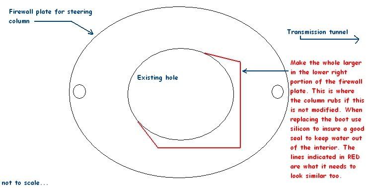

        Modify the firewall plate similar to this picture I drew up... IIRC all I had to modify was just this plate and not the actual firewall itself. I can check on that and update at a later time.

                          I had the exact same problem with the rack not lining up. Loosened the big nut inside (very, very, very tight) then everything lined right up. Didn't need to modify the actual firewall, but the plate needs to be.

                              #74
                              AH yes I did the same thing now that I think back on the actual job.
