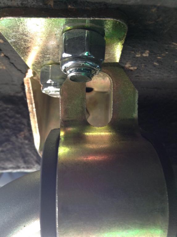

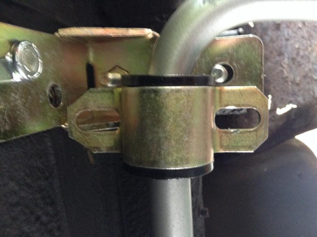

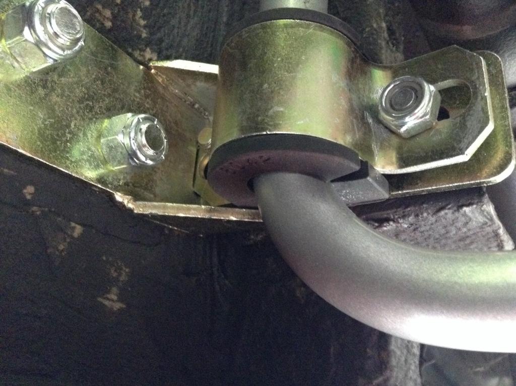

    this is a picture below of the bar with bushing at the farthest end where it hits the 90degree turn, anymore and the bushing will start to open apart.. as you can see it will not align, too far away.

      I have tried loosening the driver rear and on the passenger rear pulling it to the farthest where the bushing starts to open do to the 90 degree elbow. I did it because my partners were saying "maybe its supposed to be a tight fit" so I pulled hard from the passenger rear to show it still will not reach the stud.

            Can you loosen the bracket that's bolted to the chassis a little bit, then get the outer bushing bracket bolts started, then tighten them all down in steps to evenly pull it all together into the proper position? It's hard to tell from the pic how far off it is, not sure if that's a possibility. It's been years since I installed mine, so I don't really remember how tight it was.

              The OEM bar definetly has few more millimeters on the elbow..
              (JGood) here is a picture more centered so you can see how much more left. First picture is passenger side, as you can I have it to the farthest point where the bushing is starting to come apart..
              Second picture is shot more centered to what I think you wanted to see the distance needed.

                            I had this same problem with my UUC rear sway bar install. I was finally able to install it, but it is very tight and the bushing is pulling apart because it is right at the part where the bar bends. I emailed UUC and they said this is fine...I'm noe having issues with the end links, as the bar does not want to move up towards the body of the car to allow enough room for the end links...overall pretty dissatisfied with the fitment of this product.
