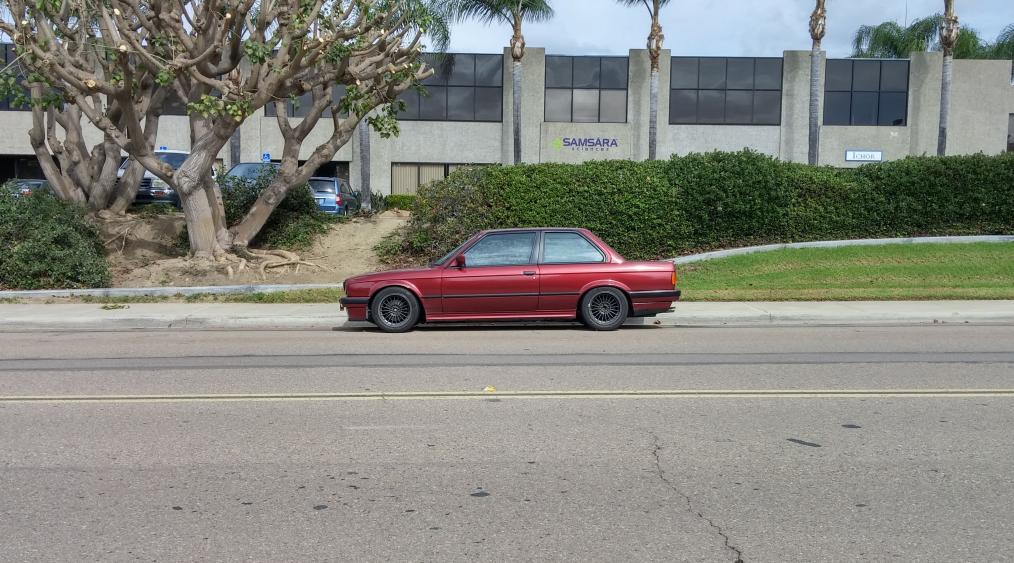

        I keep looking at the car and before/after pics and I really can't tell if the front is higher, the back lower, or both. I figured the springs might settle into the new rubber pad some, and I did camber/toe kit in the rear at the same time so that could be effecting it. It just looks funky too me.
        I may take the front lower spring pads out, but I don't think that will do much, or I may go with a slightly thicker pad in the rear to not tuck so much and get its rake back, not sure yet. Or I might just get a GC setup, or I might just stick it out until I replace it with an S2000, we'll see.....
        Here's how it currently sits, I probably shouldn't be trippin' on it. Before is in my sig. Tires are same size but the old ones had blockier sidewalls

          It looks good- these cars shouldn't have any rake. Some people get hung up on the rear arches but the ass-high alternative looks funny. The bottom of your car and the roof are parallel to the ground which is a good sign.

            Looks pimp to me. Certainly things will settle a bit.

              But in all seriousness, the lower arches are always going to make the front look a little higher, and give it that "reverse rake" look. Unless you want to start with an earlier diving board chassis, you'll eventually get used to it.

                You can always buy thinner spring pads for the front and thicker ones for the rear. That will even things out. That's what I did with my e30 vert.
