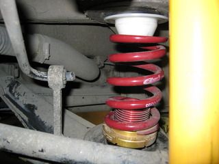

    Can you identify this suspension setup?
    I bought this suspension upgrade 2nd hand for a good price. It came off an E30 with S52 engine swap. Mechanic that removed and sold them didn't know the history, so I'm trying to ID the bits and pieces.
    Front shocks are marked with 0613P36 0335H2. Google has nothing. My best guess is Bilstein Sport F4-P36-0335.
    Front strut housing looks to be modified from stock, with a perch welded at 14.5" for Ground Control spring adjusters. Pretty much exactly like this video.
    Front springs are Eibach 0600.250.0400. 6" length, 2.5" ID, 400 lb/in
    Rear shocks are marked with 24-020275 B36-2027, so I am sure they are Bilstein B8 rear shocks.
    Rear springs are Eibach 0500.225.0650. 5" length, 2.5" ID, 650 lb/in
    Could any suspension experts out there comment?
    Thanks

    It looks like ground control adjusters to me. They label all their stuff now, so I guess it might be one of their old kits.

      100% GC spring/perch kit with bilsteins.

        Dumb question (I R Suspension Noob) but what keeps the rear springs from falling out if the rear unloads enough? They look just to be held by compression from the cars weight.

          ^^Simple answer is they don't. The only time you will see it mentioned is when someone who doesn't know better simply voices the same concern.
          I've been around many many many race setups for e30's and 2002's (which run the same rear design) and I have yet to see one come out. This includes rather devastating wrecks and cars going air borne.
              The nylon cones...which are missing.

                Do those nylon cones have a technical name? Obviously need to get a couple ;-)

                  Affectionately known as "nylon cones" at GC.
                  They will not sell them separately, but... if you send them pics of your assemblies they will sell them as "replacement parts" to complete your system.
                  Yours will need to be 2.25" versions.
