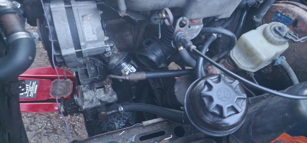

              Entirely possible and for anyone finding this on google.
              You can infact take off the belt and run the car with no pump flowing, it will be a total bitch driving at low speeds but otherwise you'll be fine, These M10 cars are like 2002's! They love to drive and drive with no assistance will generally feel like a grand ol time.
              However for doing it properly, fix the power steering issue or install a PS Delete kit like I did today. (This Photo was taken during the installation)Click image for larger version
              P.S: you will gain more room in the engine bay, Should make the oil filter change easy as peasy 🙂‍↕️
