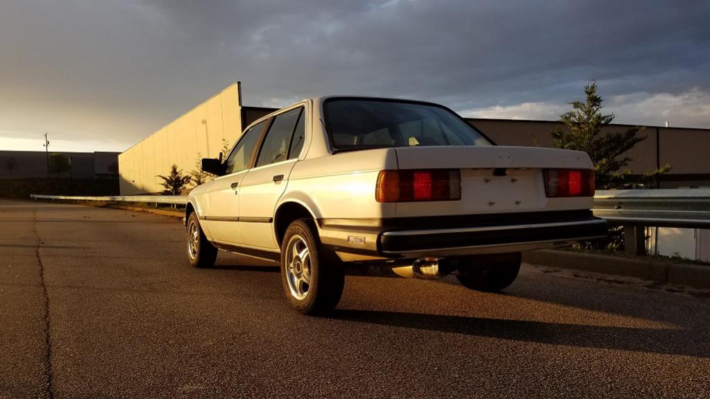

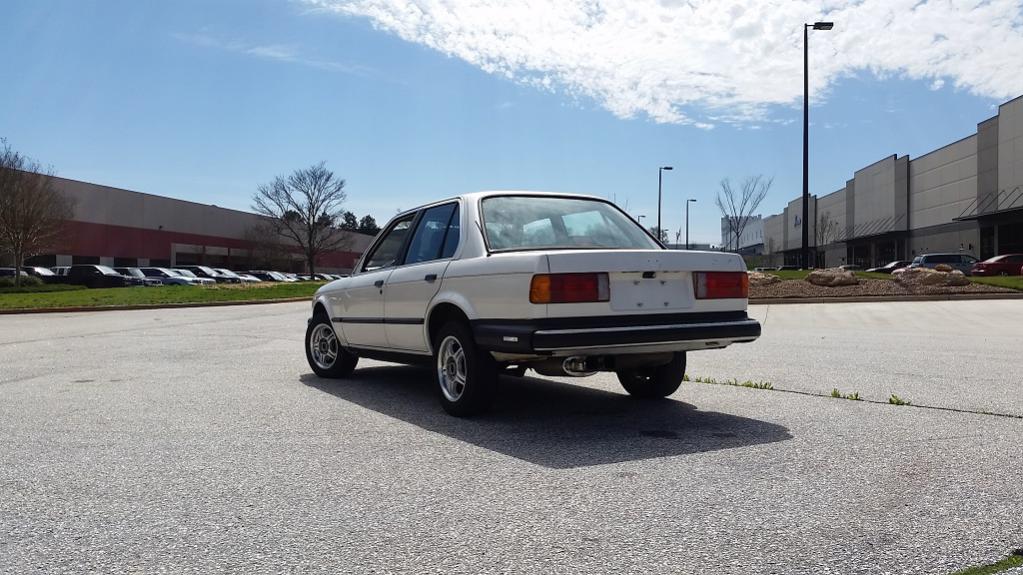

    Just as the title states, I think the PO installed the wrong rear shocks. Ever since I bought the car, I always thought it looked ridiculously high in the back. I measured and the back sits up 3 inches higher than the front. So I took a look at the stamps on the shocks to see if they match what is supposed to go on an E30. The wheel gap is absolutely massive and it looks terrible. Does this look normal?

    Here's what I came up with. They are KYB Gas A Just and the stamps on the bottom of the shock read: 553329 VG03. Now what I think is that these are made for a 1975 Mercedes (KG5533), when the KG4539 is supposed to be for the E30. Correct me if I'm wrong.
    Now here are my questions for you: Does my rear end look normal to you? ;D Would the wrong shock create such a dramatic lift in the rear? Is this truly the wrong shock? And are these the stamps on yours?
    I originally thought the early models were just made to look higher in the back, but I may be wrong. If you have any other suggestions that might cause this please let me know. Or if it looks normal to you, please tell me so I don't continue a stupid thread. Thanks a lot guys.

    First off, your tires look very undersize. That's part of it. What size are they?
    The only way the shocks would lift the car is if they were very long and bottomed out at normal ride height. Since I doubt this is the case, I'd bet you don't have stock springs. Maybe the PO put cabrio springs in or even perhaps E36 springs.

        Hmm... that should be nearly the exact stock diameter. Must just be the perspective that makes them look small.

            The car is also an early model which has higher fender arches.

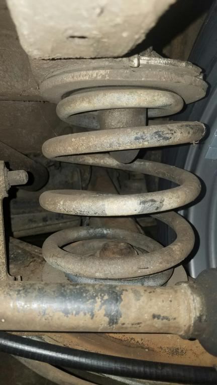

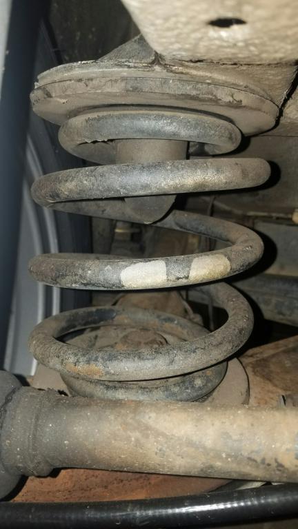

              Post pics of the springs

                  Sorry they aren't out of the car. If I need to take them out of the car, I can. Just let me know if there is anything else I can do to help resolve this!

                        Now I'm not positive they are from the Mercedes, I just looked at the number stamped on the shock and figured the first 4 were the code for the shock and saw they were for a Mercedes. I may have the right shocks after all, if anyone else has KYB Gas A Just, that'd be a sure fire way to tell. I posted the best pictures I could get of the springs. If I need to I will take them out and see if I can find some stamps or markings. They do have those 2 white marks on each one...I think my Bentley manual mentioned something about those markings...

                            Those springs are not from e30.
