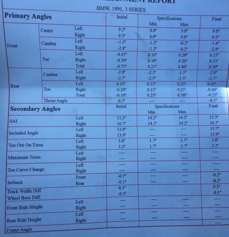

    Did they give you a before and after on your alignment? Would be interesting to know what the castor is set to.
    • ///digitalme
      • Dec 2009
      • 2088
      Yeah i got a print out of it. I left the paper in the car and i park some
      blocks from home. Ill make sure to post them

          This is the print outof the alignment.

              I love when shops give you a print out of changed rear alignment setting and charge you for a 4-wheel alignment on a car THAT HAS NO FACTORY ADJUSTABILITY in the rear...

                Yeah i noticed that^^^ they charged me 45 to align it. When other shops didnt want to do a 2 wheel alignment. But i believe my caliper might be getting stuck thats why its pulling to the side. Im going to check the calipers today hopefully thats it.
