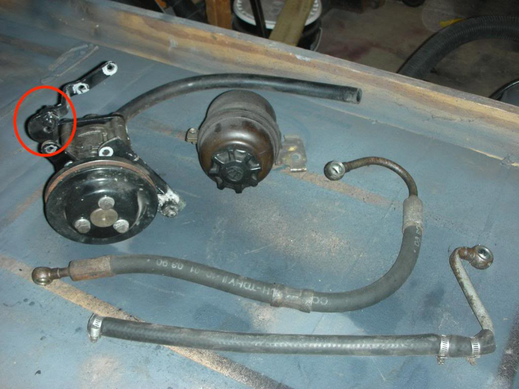

    I've looked everywhere for this odd "J" shaped power steering pump bracket, but cannot find it anywhere, including real oem. Mine sheered and so the power steering pump is cocked under the pressure of the belt. If I can't find one, my only option will be to weld this one, which would be a pain all in all. If anyone has a part number or link to this, it would be much appreciated.

    I'm sure you found it but didn't want to see.
    https://www.realoem.com/bmw/enUS/sho...diagId=32_0213
    Most likely #8 but for the Vickers pump.

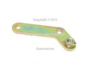

      After looking around a bit, I think it might be #9 in the Real OEM Diagram. It does mention the part superseding another part. If you look at the bracket in the attached image, it looks as though it would line up the way the "j" bracket does. In fact, they may have superseded it with a new design because of the "j" bracket breaking. I'm going to try ordering one of the part # 32 41 1 288 597 brackets and see if it lines up. I'll post back either way in case someone else it looking for this piece too.
