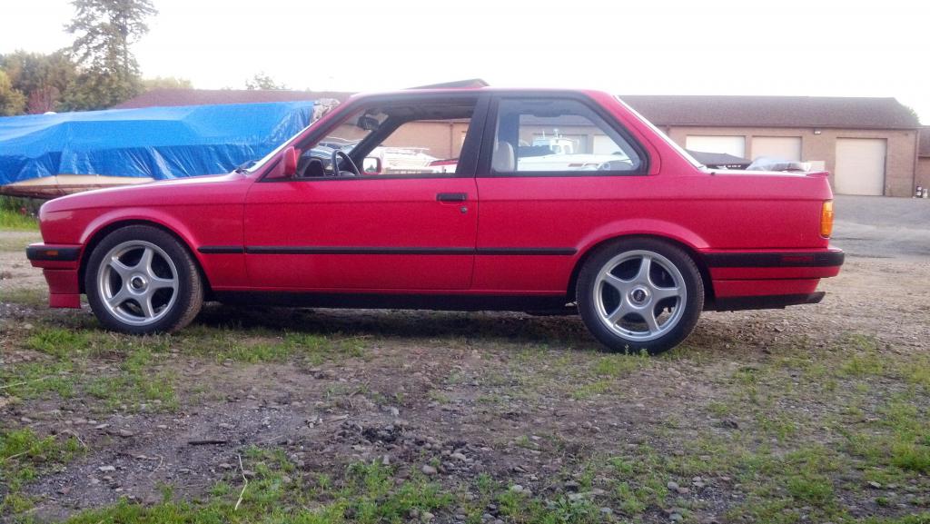

    '91 318is - I've lowered it a bit with KW progressive springs and Koni Sports. Now of course it's got too much camber, rear a bunch. So I'm trying to figure out if the offset bushing will be enough or if I need to go to a adjustable tab setup for the rear. Front - not sure what level adj camber/caster plates I need. I did get a computer printout that reads where everything is now, but I don't know how to make sense of it. Suggestions?

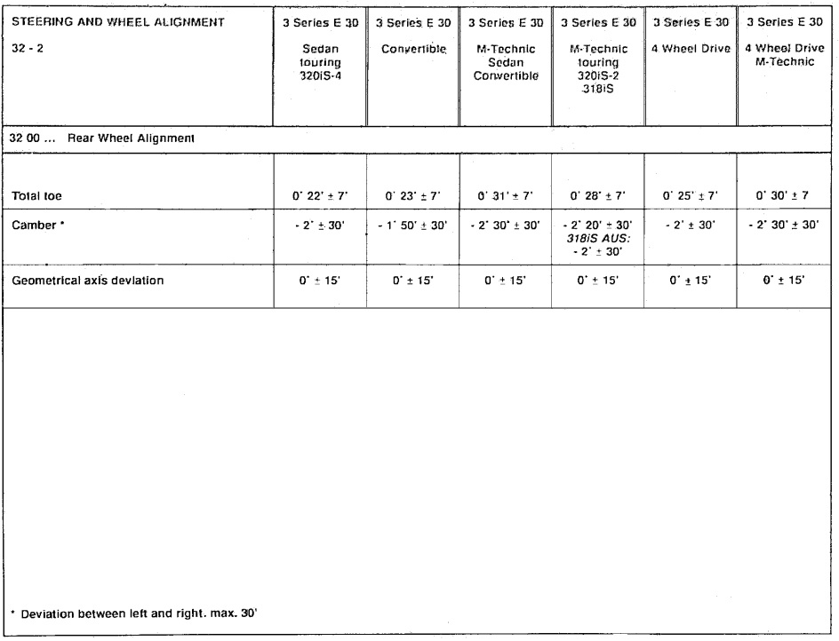

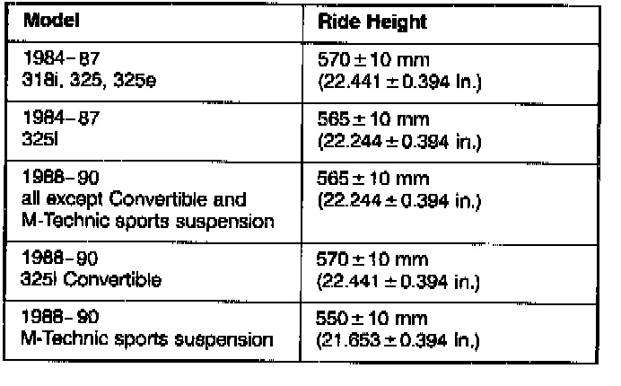

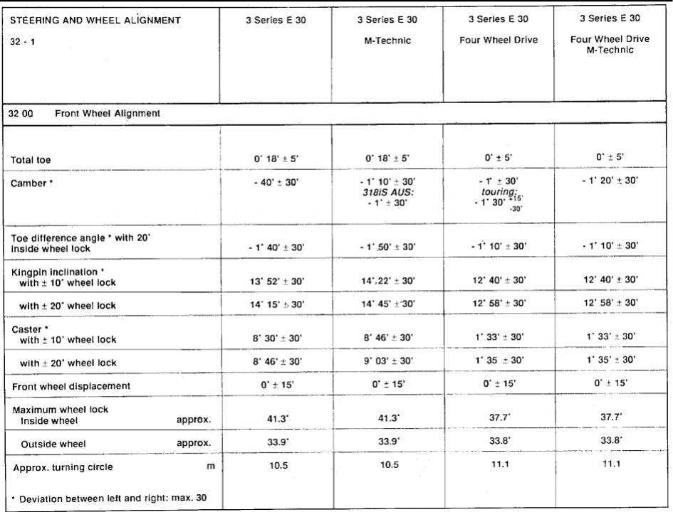

        Thanks for the reply guys. As far as "a bit", can you point me to a stock ride height chart? I'm curious too. I do have a computer print out, my buddy did it twice on a computerized setup and measured it exactly as it sits now except for tires. I'll copy and add to this ASAP. I do appreciate the help. John

          Here ya go...
Name:	e30 stock ride height.jpg
Name:	e30 front alignment specs.jpg
Name:	e30 rear alignment specs.jpg
