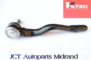

            I don't know the manufacturer but the supplier is,
            used spares,jct auto parts,new spares,car spares,aftermarket spares,spare parts,car spare parts,truck spares
            This guy is local to me about 8km drive

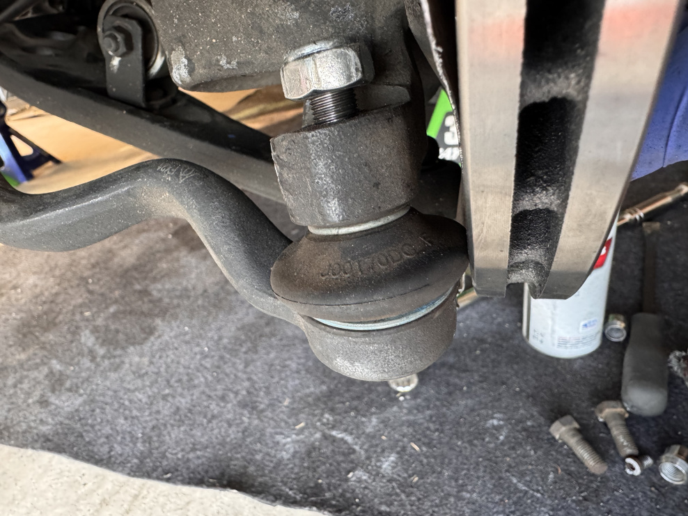

                          I’m having the same issue, Z3 rack with E36 Lemförder tie rods and 280mm Corrado rotors. Any ideas here? I’m confused because it seems the same parts that fixed your issue are causing mine. Potentially the design changed.

                            fwiw I fixed with Febi E30 tie rods.
