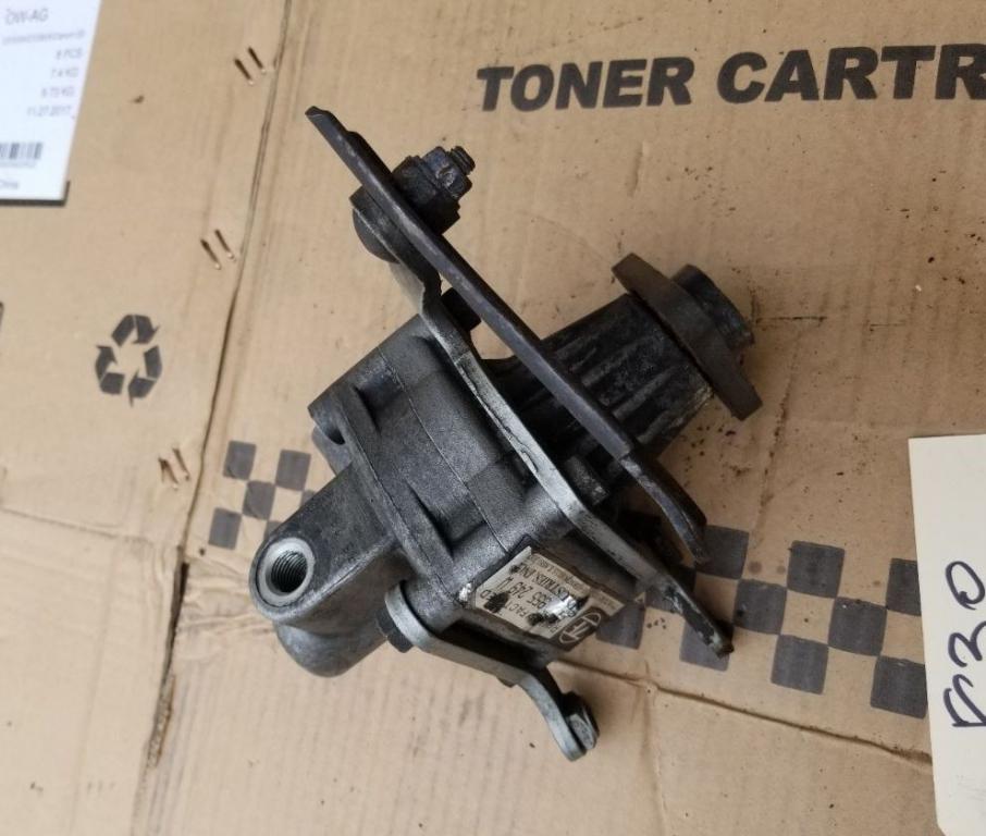

    My car came with a Vickers pump. While rebuilding the car I had rebuilt the Vickers pump. When I got the car running, I'm pretty confident there is something wrong with the pump and it's not working. Now that the vast majority of the E30s have the ZF pump, I'd like to swap to that.
    I know they're not interchangeable, I want to make sure that I get a pump that has the brackets on it that I need. Does this pump have all the brackets to remove my Vickers and install this? I assume the aluminum bracket that bolts to the block stays the same?
    I attached the photo of my current pump. Does the ZF pump use the same brackets that bolts to the aluminum bracket?

    I guess in case this comes up for other people. The ZF pump bolts up as long as it has the brackets that are physically bolted to the pump itself. The brackets on the car side are the same.
