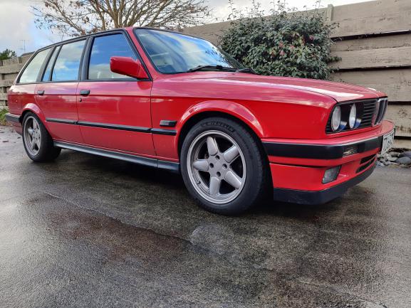

                I've got an H&R sport kit for a sedan in mine, as Kronus says, it's a good compromise, and I've been using mine as a daily with some light track duties.
                It's a bit lower at the rear, but as Julien says, cab would be better to level things out. Or H&R do a touring specific set as well.
