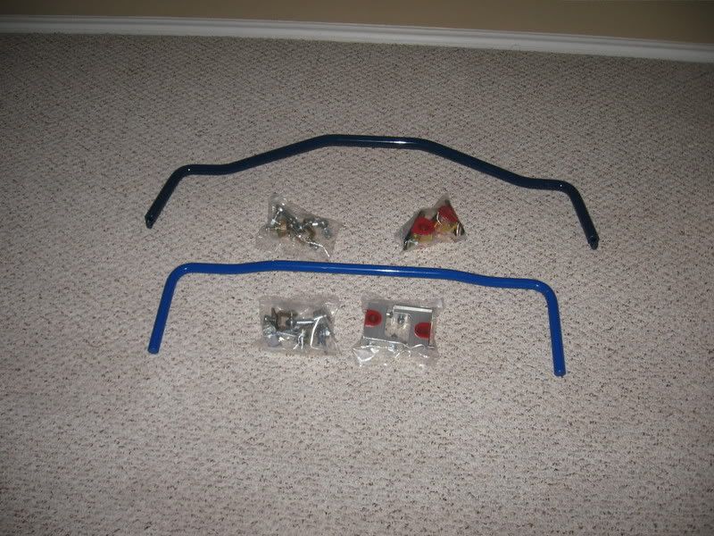

    Got mah sway bars!
    Finally!
    IE 25 Front 22 rear.
    But have a couple of questions..
    How hard is instalation? I think I need to weld the rear bars reinforcements correct? Is there a way I can install the sway bars, then drive up to a shop and get them to weld them, or is there a better way around this?? And I have the H&R Cup-Kit, am I going to notice a difference?? If somebody who has the H&R cup-kit with thicker sways, please don't hesitate to answer me!! Also, does anybody have install directions on a PDF or something for these?? for some reason mine didn't come with any instructions.. I thought it would

    You could always put the rear sway in and leave the links off and drive to a shop and have them weld on the tabs, then attach the sways. I love my 25/22 sways with my H&R Race/Billy sport. Really nice setup.

          The rear bar mounts are attached through the floor of the trunk. You will end up drilling 4 holes in the trunk, passing the bolts through the reinforcement plate, then through the floor, into the bar mount.
          The end tabs need to be welded onto the trailing arms
          On the front should be pretty self explanatory.
          GL!
          Luke

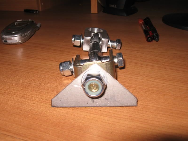

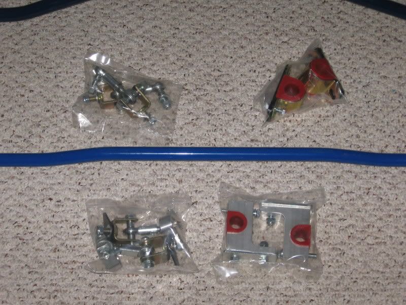

            ok, sweet, and does the kit come with the brackets that need to be welded, or am I going to have to make them my self? I think it comes with it, it's connected to the rear sway bar links??

              I dont see the trailing arm reinforcements in those pics. With a 22mm rear bar I HIGHLY recommend that you do the reinforcement tabs.
                the little kinda triangular bits are the tabs that should be welded on.

                  ok, sweet, I think this is it??
                    Yup, thats it. I still think the Turner's are better but those will work.
                      Yup. Note the little triangle is not unilateral. You will find it is made to fit left or right. Place it under the stock one (IIRC) and weld it on.
                      I am gonna make some swaybar mounts like those for stock "is" bars and "Energy" bushings...cause I am cheap.
