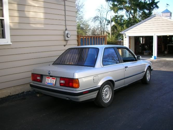

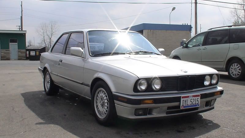

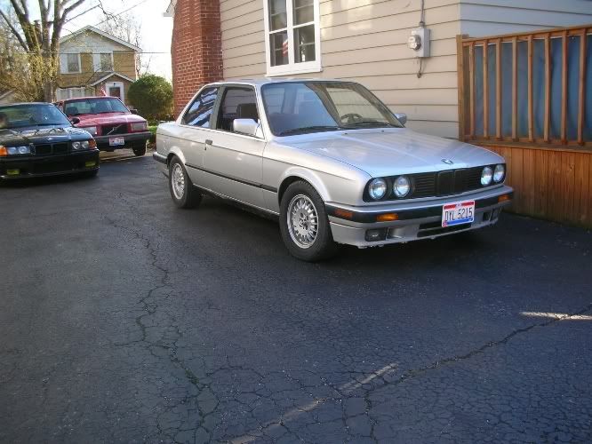

    When recently shopping for springs and shocks for my 325, I came across the BTS kit, but could not find any reviews or pics of the setup. I wanted something very streetable, and with the lifetime warranty, I decided to go with it. To clarify one thing.... The springs are not made by H&R. They are matched to the bilstein strut and outsourced by Hyperco. Anyways, I installed them yesterday along with new control arms and tierods. The ride quality is very nice. The suspension is much better than the tired stock suspension, but I am sure the new control arms and tierods are helping out as well. If someone plans to purchase this setup, make sure you buy the 4 dollar strut tool for easy install. Below are a couple pics I took 10 minutes after I took it off the stands. In a few weeks I will post new pics if it settles significantly. Also, please forgive the dirty car, poor alignment, and missing front spoiler (in the mail). Hopefully this might help someone decide whether or not to choose this kit. Cost: roughly $600

    5 days later with a lip
