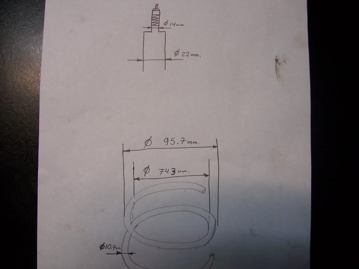

Hey guys,
I'm runing 5 lug conversion with e36 parts. However I cutted the e36 shock and used the body with custom threaded with my Koni adjustable e30 stock insert shocks. However I'm runing stock e30 upper spring perch ( I think that's the name in english) as you can see in the picture below and I'm not sure what GC buy.
They offer two models, one pictured and other non pictured but expensier. Calling there seems doesn't help much as I'm not sure if the guys over there know what I have really even sending pictures.
This: http://www.ground-control-store.com/...hp/II=142/CA=8
WITH: Koni 14mm and "XXXXX" (what spring perch select)
or: http://www.ground-control-store.com/...hp/II=722/CA=8 (wich doesn't have much info)
Here are my messures and system:
Thnaks,
-Diego
