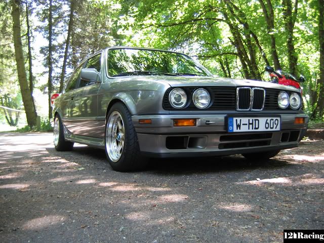

                  I have a H&R cup kit and I love it. Soft enought to drive daily and stiff enough ( with really big sway bars ) to race. Here is pic of how it sits

                            look at the front fender clearance e30 ideas and h&r website compared to my mine and terribleone's sig
                            cup kit
                            race springs
                            www.gecoils.com
